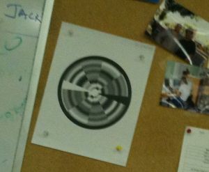

Different flavors of Fiducial Markers
fiducial markers
fiducial markers
fiducial marker
fiducial marker
